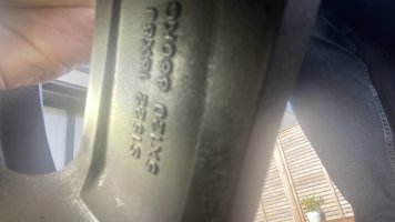

So in a continued bid to find the load rating of the wheels, I took one off this morning. I understand the first two images show an offset of 55mm and a wheel size of 8x18, J hook rims and 2 Hump design. However, I’m at a loss decoding the rest and uncovering the load rating for the wheels. Once again, can anyone assist please? Feel like I’m floundering a bit. Thanks in advance
No idea from those markings except possibly the B808 meaning 808kg?
Maybe look up what they are on the Autec website and see if you can find the specs.

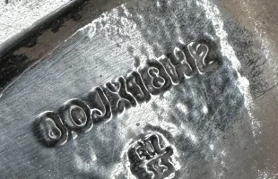

Mine had much clearer markings:

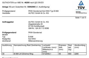

Thanks for the steer @ginkster . While there was nothing on the Autech website directly, it turns out the B808 is the wheel model number. Using the associated KBA number from the website, I was able to track down the Tuv approval certificate which shows a wheel load of 900KG is approved.
Weight plate on the van shows 1550KG per axle. So I guess that the wheels are all good :)
