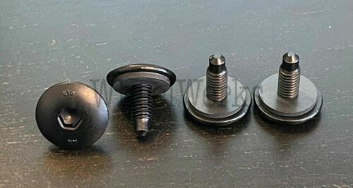

What bars have you got? if they are the OEM style roof rails then the OEM plug is very different from the bolt holding the rail on. You will most likely need OEM plug to put back in the hole once you remove your rails.
Rails bolts will be alot longer
If you've got the stock ones they have the sealing washer under the wide head like this
It's not the sealing the threads to worry about, you need to seal to the out roof so no water gets from the gutter into the bodywork.
yes you will need different bolts to go back in. these are the ones that go back in
VW T6/T6.1 Satin Black Aluminium Roof Rails – SWB
Although I would be tempted to put an M6 back with a roof washer like this:
