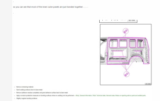

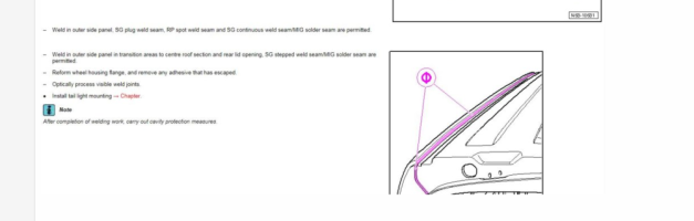

its mainly bonded on, but also spot welded in places.
thats going to need bodyshop attention and paintwork done - gutted for you, assuming your not the original owner.
take a look here:
Roof replacement from a donor to eliminate a bad pop top installation?
looks to me like it's had either a roof or side panel repair with little or no prep prior to painting, i'm sure the side panel is only spot welded and panel glued on and they look like masking tap lines for the seam sealer under the paint.

It will have been plug welded along the top as you can't spot weld without a robotic welder and that is where the rust will have started along with the absents of etch primer. It wouldn't have been cleaned on the inside and protected with sealer, paint and wax oil. Moisture in the cabin will have made it rot from inside out. Unfortunately the only way to sort this out is to remove which ever panel was fitted as it will be in between all 3 layers. Anything else is just a makeover and will come back.
