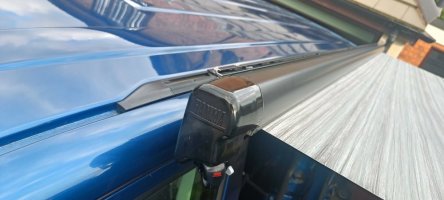

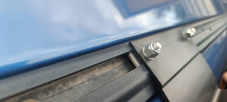

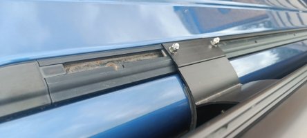

Hi All,
Have used the search but could quite find what I'm looking for. I have one roof rail attached to my T5 (for the side canopy) but I'd like to fit one to the other side so I can fit a solar panel. Does anyone know if this is a genuine item or where I can purchase the other side? Its a 2015 LWB.
Thanks in advance :)IMG20230901172658.jpgIMG20230901172700.jpgIMG20230901172704.jpg
I think the other clue is the rear has this wider area on the track for the roof bar feet to drop into and slide forward, are yours the same?
I'm mildly surprised they are not fitted as a pair. I'm sure a van centre parts dept could help but might also be worth a quick check around eBay.
I believe so, I've not seen anyone else producing similar systems the aftermarket ones seem to mount directly to the 4/5 bolt points.
However I've only been tinkering with T6.1 and only for the year so there may be an OEM part too.
Yes this is the roof rail prep that VW sell. I think I bought some back in 2008.
You would have to check costs, I'm thinking around £100 a side but it was 2008 !
