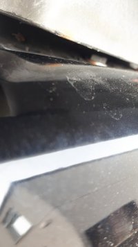

Hi, apologies for the rookie question if it’s already been answered…. Had a search but couldn’t find anything specific. Bought my T6 with a set of 2 non-oem racks attached. They were each at the far ends of the van so went to move them closer together (for roof box and surfboards). I was surprised to find that they were held onto the roof with just some tiny little bolts in the standard fixing points!! Surely this is not the right way to do it??! Am I missing something? I wouldn’t feel comfortable carrying anything more than a polystyrene slab on them right now!

Thanks, @bubbadubba. Good to know. I’ll post some pics soon for comparison.

Yours looks absolutely fine - although for peace of mind I'd swap out the bolts with rusty heads for new ones when you move the roof bars. Not 100% necessary but nice to know you've done it.

Thanks for that! And taking the time for pics! I think the collective knowledge is that it’s all good. Just need to change the bolts for new ones and torque them up. Thanks heaps!
Legend! Many thanks. Makes me fell 100% more confident. Cheers!
