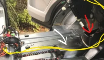

have a look at @Deaky awsome build thread . . .,
route shown in yellow. - you can fish the cable without removing the seat and carpet.
Not that I doubt your advice but how on earth do you fish the cable through that maze :)
I'm guessing I'll need to remove the center/lower section of the dash to get access to the point where I've added an arrow in red:
But even after that I'm not sure how I'll get a cable through the rest of the routing channels.

yep take out the glovebox,
then
lower left and centre dash panels.
that gives you access to the tunnel.
you can then fish to the seat base.
just lift up the rubber or carpet flooring and look for the OEM loom . . . . just follow that.

I've come to learn that I should (hopefully) be able to access 'the tunnel' simply by removing my bottle holder:
