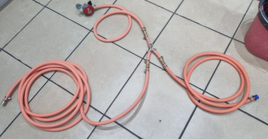

you can split the gas hose with a Y or T piece, . . . the Gas Regulators only have one output.~?
you can split before the hard line.
i made my own for the cadacs. . .

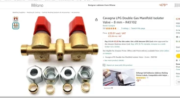

I was hoping to get one of these that provide two outputs and then have one supply the van as before and the other connected to a bullfinch styler connector mounted on the face of the wardrobe. I would then use it when the tailgate is opened and connect in my quick connect cable.

so looks like that manifold as shown above could be the way to go. . . . ?
but it would need to be fitted after the regulator, basically Teed in to the hard-line?
Yes that manifold would be after the regulator which would likely mean dismantling part of the conversion to do it. I was hoping to find either a y valve that fits directly to the bottle or replace the regulator for one with two outputs and a manual switch over between them. I can’t seem to find either.

Thanks for the help. Just been reading up on some of the regs and they say connections must be teed off after the regulator or the 8mm going into the van which is why they likely don’t exist.
