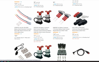

Anyone have any idea why this may not work or what problems could occur ..
seems a good way of monitoring the power consumption of my fridge and also protecting the leisure battery .
My fridge was using a lighter socket type adapter that to be honest is just pants . It was put in as part of an installation I paid for and nothing really fits it correctly.. so I wanted to create a more solid reliable and safe way of plugging in my fridge and the load output of the victron seems ideal for me .
My compressor fridge pulls around 6 /7 amps when running which seems well within the ability of the victron 100/20 load output .
