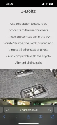

Does anyone know of a product on the market that acts as a adaptor that can be used to fix to the existing kombi rear seat floor mounts?
im planning to make an mtb stand/rack like in the image but mine will be marrower and so id like to fit it to the floor via the seat mounts.

Think i may get one and modify it to bolt down to the seat points instead of having tie downs slung all over.

I have a SWB kombi and brought the 2 bike Bikestow rack. I drop the back of the rear bench then fold it forward. Using the straps provided with the bike tow i fasten it down using the seat mounts.
Works a treat for me
