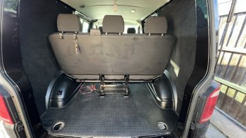

The seat in the rear row position in my SWB means I have about 2ft between rear of seat and tailgate. Pictured here….
From the factory you can only get the 3 seater bench with the middle 4x floor mounts in the rear row.
I have seen someone do a 1+1 squeezed in between the wheel arches but this is not factory option. Neither is 1+1+1 unfortunately.
If you need to know the exact size let me know and I’ll measure it for you.
