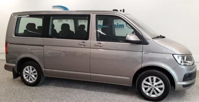

Hello, seeking advice before I go and buy a T6 for the family.
Interested in buying a T6, 2016.
The one i´m looking at:
Mojave beige
140000km
2.0 TDI (150hp)
Manual gearbox
- Are there any known pitfalls on this engine/gearbox combo. I have read some threads regarding the dual mass fly wheel?
- I purposly looked for a manual van since I wanted to avoid the DSG gearbox, I have read alot about problems regarding
that gearbox in swedish car magazines. I mostly drive on highways and have only driven manual in the past.
Will this choice reduce potential probems i.e. are a manual more "bullet proof" than a DSG?
- What do you think of this as a family car?
In Sweden where I live it´s not that common with VW vans as family cars, the cars of chioce are small SUV:s and of course
the gold standard Volvo station wagons. However we are expecting twins and to squeeze three (we also have a 4 year old)
child seats into our XC70 will be a real pain.
- Are there any good buyes guides available somewhere?

Thanks!
Yes the milage are on the high side but I cant really afford a lower milage one.
I would have to pay £45.000 for a 4-50000km van here in Sweden, this one that I´m looking at costs £25.000.
So it´s somewhere around £20.000 to knock of 90000km.
Good point with the isofix:es, I will be sure to double check that.
It has the "seats on rails" so thats good, it also has a integrated child seat on the outer chair.
Could be useful if we bring a friend to the kids with us.

The photos you posted above show the van has at least isofix on the middle right seat (that's what that little blurred label says). So safe to assume it is the same on the middle right.
My rear bench does not as I have the sleeping/bed pack. Not sure standard rear bench does.

Go for the higher powered van! Just had a look at your second pic....those individual seats will have the isofix and I think there are 2 x isofix on the “bench” seat behind!
