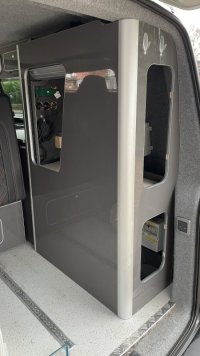

@Jimquested this is the shelf I put in our long cupboard, which serves us very well and makes good use of the space at the top.
I obtained an off cut of the laminate material to match the main panelling. However in the end I used an Ikea door, which is suitable grey colour and has an edge lip which I put at the front. It is cut to fit snugly and screwed through from behind the walling. I am aware though that’s its an mdf not ply material so less strong than I’d like. Cupboard lights were from Wilco, sadly missed, but I’m sure there are others available.

Thanks, it looks really good! Sorry just to clarify have you screwed through the cupboard left/right side when looking at the second picture? Also, do you know what material the paneling is generally made of that lines the inside of the vans that have been converted. I was thinking of screwing into this for the shelf and also putting some netted pockets on the side of the van near the rock and roll bed. Thanks for the advice.

@Jimquested yes I screwed through the panels from the left and right hand side. Access to the other side limited the range of possible shelf positions, but the result has been fine. This panelling is the standard lightweight ply like that most often used in conversions. The shelf is a tight fit into the width.
