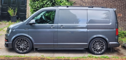

This is my van. It's down about 160mm on Solow lows and 235/35/20 tyres. For me, the ride is great! Yes it is a bit crashy over rough terrain and it scrapes to hell over speed bumps, but on smoother roads and motorways it feels just like a sporty car would.
How low you go, and what wheel/tyre combo you end up with is mainly down to what you can live with. But for me, low is the only way to go! Haha
