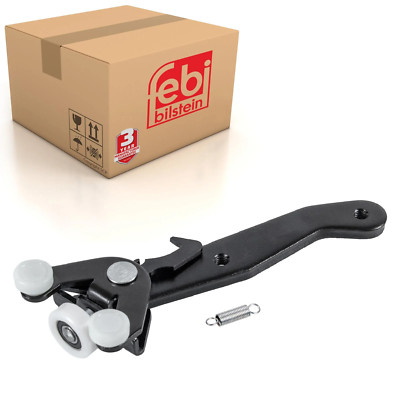

I bought a Febi one for £18 and it's spot on. Just check if yous has got the latch.
With
Without
So far the cheap one has been ok
Time will tell, but I have the original ready to go.
Also they are handed so make sure to get the correct one.
