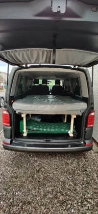

I looked at using cut down ikea Adils screw on table legs (£5 each) and a sheet of ply to create a platform in the rear to go with the kombi seats - you could easily make the same for the mid section along with an inofia folding matress. You could also put the front seats on swivels to create extra room.

Ok, here was my process.
Bought CLS timber to build a crude base in the boot. The rear bench folds flat and the rear base in the boot area was built to the same height as the forwards folded down rear bench. I then bought a futon 4 inch foam double mattress from Ikea. The mattress lives in the rear, on the base, behind the rear three seater bench, day to day. The rear bench folds forward and the futon mattress pulls out flat.
This worked for a while but the bulky CLS timber (google it) wasn't efficient for usable space under the base. I then bought two 8 foot x4 foot x 22mm thick plywood sheets and made a C shape to go in the rear with the long end up against the rear bench. Then I put a thin cross bar of timber in the front, and placed a larger board on top. I added stretch carpet to the base with thicker house carpet to the top.
It now lives in the shuttle. The futon lives on top, folded. I did have to cut the larger futon foam in half to make three same size sections so it folds flat like a Z. Our luggage in sold bags fits nicely underneath and I cut a 'window' in the passenger side to access the jack etc.
I should lastly note we have a long wheel base, so the base in the boot, and the rear seat folded forward is long enough for the mattress to make a comfortable bed base. A SWB van might need a longer base board folded out over the rear bench to extend long enough to accommodate the mattress.
I'm away from home this week and will try to get images here but reception isn't great for uploading images here.
Here is the current setup. Without the front thin strip the sides are quite flexible and you do loose a slight bit of space, but we usually tuck stuff under, and also have bags of stuff in the middle as we travel with the middle seats removed also.
In this picture the bench is folded forward and the mattress is pushed forward on to it to make the bed base more visible.
