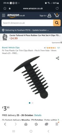

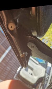

The rubber on the bottom of the sliding door acts as a seal to any water getting in. The water has nowhere to drain and fills up into the slider channel. I removed some of the little T clips that hold the rubber to the sliding door, cut holes in the rubber and used some push in trim clips to create space between the rubber and the door channel to create drainage. Works well. Haven't had a problem since. Screenshot_20231018_222009_WhatsApp.jpg

The rubber on the bottom of the sliding door acts as a seal to any water getting in. The water has nowhere to drain and fills up into the slider channel. I removed some of the little T clips that hold the rubber to the sliding door, cut holes in the rubber and used some push in trim clips to create space between the rubber and the door channel to create drainage. Works well. Haven't had a problem since. View attachment 217244
Do you happen to remember which type/size of clips worked?

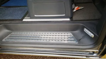

When I first got my van (2016 MY) I pulled the plastic sliding door step out and found water underneath. Their was a longitudinal channel in the body from behind the NSF wheel arch liner that was open all the way through to the sliding step. I plugged this at the wheel arch with mastic and drilled a hole in the plate at the step to allow the water to drain.

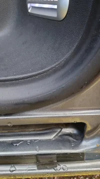

I have some dense adhesive foam so currently I'm trying putting a postage stamp sized bit on the bottom rail so it's right under the bracket when it's shut and holds the seal slightly out to drain.
Handy thing is on the grey it's almost invisible. I think even on other colours it would look fairly stock.
Luckily down south we have a lot of rain for testing right now... so far opening the side door has not resulted in a pint of water falling out so... seems to be working
