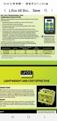

Also noticed that your Ctek is a 250sa Which does not mention suitable for LiFOS type batteries however the 250se model is compatible, if this is a new install I would question it with your installe.
The lifos spec sheet states.
D250sa compatible.
But will only charge to 80% as it doesnt have a lithium profile (higher voltage.. the d250se is the upgraded version)

Hi, my CTEK 250sa was installed just before the lithium compatible CTEK was released - over 2 years ago. As far as I’m aware it works fine but is only capable of charging the battery to 80% as opposed to the se which will charge to 100%. The installer did make sure there was a direct charging lead to the battery though so when on hook up I can can charge it to 100%.
