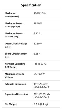

Looking at the Dokio 100w folding specs you're right on the limit (just over) for the voltage on the Allpowers input 22.5 on the panel and 22v on the input:

I'd get a multimeter in voltage mode across the unconnected panel and measure the open circuit voltage, then do the same in high current mode and check the short circuit current and see if they are in spec.
