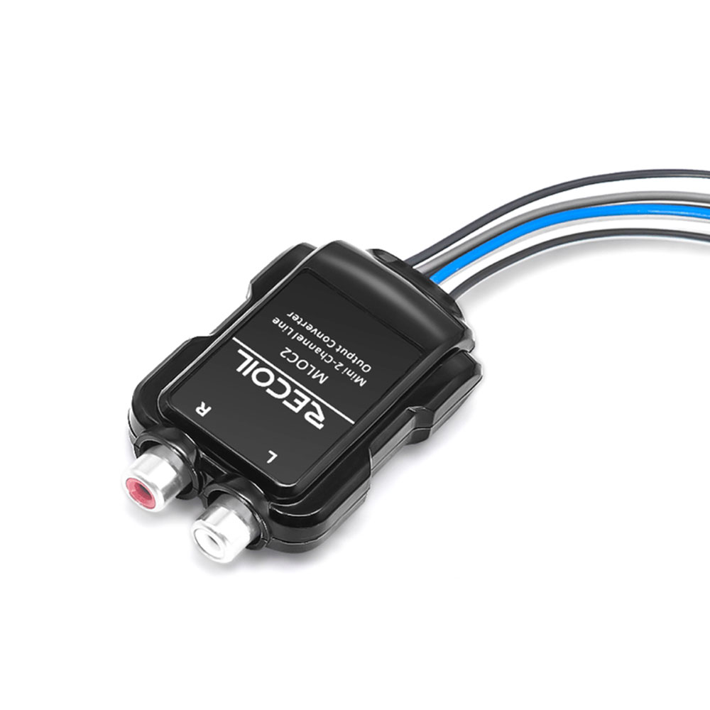

More thoughts/questions on this as I try to do a temporary upgrade with current kit (front components, sub, 2amps)...
How would I best wire up to amps to a standard headunit?
  1. Use rear speaker outs for mono amp - If I could get VCDS coding done to enable rear fading then I'd essentially have a volume control on the sub. I'd need a remote signal for the amps – Something like this?
  2. Use something to split the front speaker outs to both subs. Is this the sort of thing I need to be looking at?
    Anything better/more appropriate/cheaper?
Could the remote out from the channel converter (option 2 ) be used to control 2 amps?
With option 2, if there isn't a proprietary sub volume remote available, how would I include a volume control on the sub?
