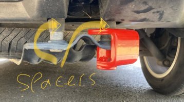

Are you sure the two spacers are still in place? The bolt is part threaded so it will only tighten until the end of the thread.
If you remove the bolt you’ll see if the thread is damaged, if it is you’ll need to run a tap through the nut and a die over the bolt.
Thanks - is that a 6.1? From memory, mine didn’t have spacers and the non-captive bolt does up fully flush…
