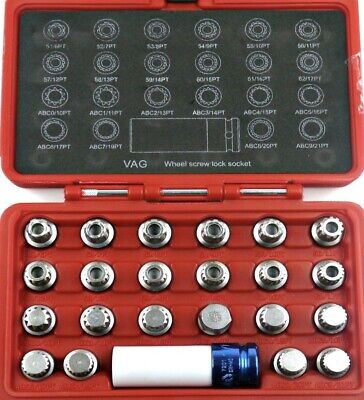

I bought a replacement key from a guy on eBay, send a pic of the locking nut and he'll send the appropriate key to match it, it cost £16:50 and it arrived within 2-3 days
Good business for re-selling, you can buy 23 keys for less than 50 quid delivered.
23 x 16.50 = £379.50!
IMO go for the VW genuine key, a poor quality key could cause extreme disruption if it isn’t up to the job when you really need it.
Except that set is for the old version keys, not ones in current use.
I phoned Sinclairs in Swansea and Cardiff, both said they couldn't help even if I brought the van in to match the right key, there's 1000 different keys apparently, and no record of what key was used on what van, even the sales guys thought it would be common sense to log it in case the key is lost (quite common apparently)
I considered buying a set of keys but I couldn't see the matching key in the sets and didn't want to take a chance.
I don't know where the individual key I bought came from originally, I assumed the seller has a list of part numbers and pre orders from tps, hopefully they aren't made of cheese, I'll report back when I have or haven't taken the wheels off ;-)
