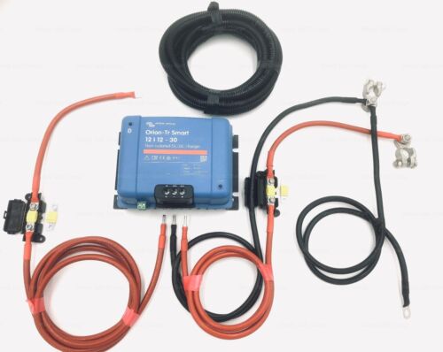

Take a look at these…
as above, dont use a Split Charge Relay on a T6 with stop/start
