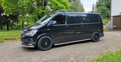

T12 Instagram @forestroadexplorer VIP Member T6 Pro 23 Sep 2021 #3 Yes it will fit, have the Eibach -30/40 prokit springs, and general grabber at3 235/55 R18.
