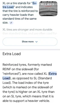

The front tyres appear to be load rated at 99?
This would equate to 775kg each or 1550kg per axle.
And from the VW T6 brochure;
That would limit T6s to T28 or T30 with 102ps engine and 5 speed gearbox.

I assume the Extra Load as it says on the tyre (ignoring the 99) is the same as XL, so should be rated ok? Are you looking for a sale only? Thinking of changing my nearly new Wolfrace Wolfsburg 18s with nearly new Bridgestone Potenza Sport tyres.

Its all a bit bizarre really. So according to the above an XL tyre can support a heavier vehicle than a standard "non-XL" tyre.
Implying a 101 XL tyre can support a heavier vehicle than a 101 non-XL. It pretty much makes the load rating gobbledegook. It would make more sens to get rid of the XL bit and call a 101 XL tyre a (for example) 102 tyre. Current system seems a bit stupid.

For a certain size 101 XL is higher than a normal (SL) tyre of the same size, which may only be eg 96-99.
The standard tyres for the standard wheels on our MINI Cooper S are
205/45R17 88W XL where W is the speed rating and marked XL as 88 is higher than the normal rating of a tyre that size. A Bridgestone Potenza S001 of the same size is available with an 84 load rating, which wouldn’t suit our MINI.
Perhaps XL is added to draw the attention of those not too familiar with the load rating tables vs kilos per wheel vs kilos per axle?
