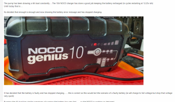

Noco genius 1 is a 1A charger..... You sure?
That Will take days and days to charge any battery.

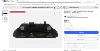

no, unless you get a gizmo that will trickle charge the starter, from the leisure battery.
or
you can use one charger to charge the starter battery, to the point that it turns on your dc-dc charger to charge the leisure setup - but you need a large charger and its a faily waistful way of doing it.

fyi - the NOCO`s are not great for leisure chargers. they stop after a day or so.

Great info, ordered a 10A charger and a BM2, I'll get a second for the LB as I assume I just need one even if I have 2 x LB's.
The two leisure batteries should be connected together.... So one charger should charge both.
If you have two batteries, then look at the larger charger... Ie 20-30A.
Ie, 10A + 10A for each battery and 10A for you loads.... 30A.
A 10A charger will split down to 3.3A + 3.3A per battery for charge and 3.3A for you loads.... Which means very slow charge rate and possibly under powered.

Unless you connect your starter battery to a battery conditioner (I use a CTEK MXS-5) you’ll not achieve anything like its maximum state of charge. If you have a leisure battery which is charged from a mains charger connected to the EHU then, as others have suggested, installing an Ablemail ABT-12 will help keep the starter battery charged. Maybe fitting a solar panel and an MPPT charge controller is another way of putting charge into the batteries if you’re parking up off-grid too.
Thanks for the reply Captain, I do indeed have a 6.1 with solar and would live with 80% battery SOC but I’m down to 60% and on my third starter battery.
I will invest in a AMT12-2 and try and find the settings for my Orion Smart charger.

The quick fix if you are always on EHU is the fit a second 5A battery charger to the SB.
If you are mainly off grid with solar and dc-dc charger, then you need a SB maintenance charger, that chargers the SB from the LB.... In my case I've found the Able mail AMT12/2 to be the best device...and I've tried most of them now.
It trickle charges the SB... So as long as you're LB bank is keeped charged your good to go indefinitely.
