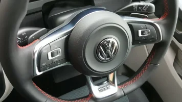

I managed to find a new GTI polo steering wheel with DSG paddles and air bag. I wanted the red stitching and the red illumination on the switches to match the rest of the dash, so following the fine work and advice from @RattyMcClelland i new what steering wheel i needed to achieve this. The only problem i encountered was i could see the wiring loom on the GTI airbag was different to the T6 wheel. I installed the wheel and bag as it was wired just to see if it worked . It did.... apart from no horn or cruise control

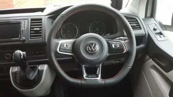

.... So i swapped the T6 wiring loom onto the gti air bag and result it all worked perfectly paddles and all
. So i think thats all the steering wheels covered for what ever type and version you would like, @T6 dork has done his conversion to paddles and flat bottom wheel with the standard airbag.
so if anyone else wishes to do a steering wheel mod you know what to do now and what works
