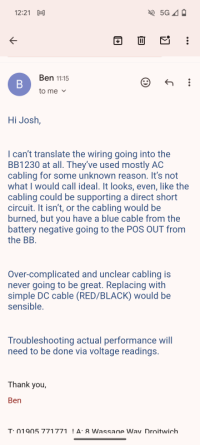

looks like its been installed with mains cable? - 3core flex?
which is not suitable.
and the cable gauge looks to small.?

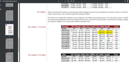

so you should have at lease 16mm2-25mm2 cable (see page 13)

though id imaging the initial problem is a blown fuse caused by excessive current, caused by voltage drop over the incorrect cable for a DC-DC charger.
The conversion was done by Platinum Wave Campers in 2021 though I am the second owner since it was done. I called them about the issue and they ensured me the wiring is correct.
This is the chart for my unit, 10mm2 cable which looks right.

So you have a 30 amp DC DC charger.?
And you have the charger fitted in the rear of the van? Which is about six meters of cable away from the starter battery?
The chart shows 25 mm squared cable upwards.
York cable looks like 1.5mm? or 2.5mm? mains cable?
Take a few pictures of your cable close-up there will be a cable marking on it.
Also send Stirling a email with these pictures and ask them for confirmation, I'm sure they will say this is incorrect.
Those quick connect battery connections look a bit if a as well for our 30 amp charger. I would have used solid battery terminals.
