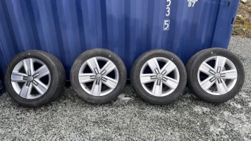

I suggest you might need to look at 17" wheels and suitable chunky tyres for a T6.1 especially if yours if a T32 as the brakes are bigger and might not fit over a 16" wheel.
Did your van come with Clayton or Devonport wheels?
These are 16" claytons

Thank you for your very informative reply...my van came with Claytons as Per set against the brick wall, are they different then ??

My van came with Clayton wheels and thanks for your reply is there a reason you asked ?

If it had Clayton’s then it is the standard sized brake disks which means you could fit 16” Swamper wheels.
I have also seen Clayton’s with BF Goodrich tyres like I had on my van - looked good.

Thanks for the info...was just the advice I needed. Cheers
