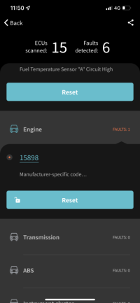

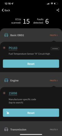

Hey, I just purchased a Carista and read the following:
Engine
Fault codes:
Component: R4 2.0l BTD
15898 Manufacturer-specific code

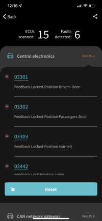

Central electronics
Fault codes:
03301 Feedback Locked-Position Drivers-Door
03302 Feedback Locked-Position Passengers-Door
03303 Feedback Locked-Position rear-left
03442 Feedback Lock-Position Trunk
Adaptive cruise control :
Fault codes:
01538 Motors for beam adjustment (V48 / V49)
Everything else is faultless

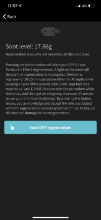

Interesting. Apparently I don’t need to regenerate however according to Carista obd port
