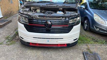

Hi all I have done t5.1 to 6.1 facelift and put the diodes between pin 10 and pin 4 but when I put the side lights on they come on and go off and then don’t come back on even if I turn the light switch off and on again. The only way they come back on is the turn the ignition off and on again but still come on then flash a couple of times then shut off.

Hi all I have done a 6.1 front end conversion on my 5.1 and I’m having trouble with the headlights
I’ve spoke with travellin lite and obtained the diodes which you put between 10 and four wire, but my side lights don’t work properly.
With the engine running the side lights go out, but we’ve just the ignition on they both work
I am attaching auto scan, so can someone please help me with this.
