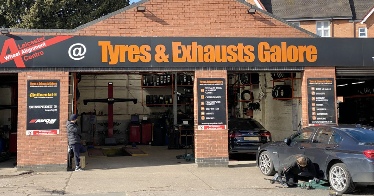

Don’t know if this will help but after I had my van lowered I had Hunter wheel alignment done. The first garage I called said that if they did it they would also have to calibrate the sensor for the acc and charge me extra for the pleasure. Anyway I went to another garage to get mind done.
might be worth a call to them? Link to their website (based in Leicester)
