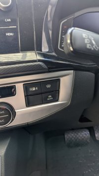

New to this Forum, Currently drive a T5 Sport Line and have purchased a T6.1 which is currently in the process of being built.
I'm after a bit of help with some missing buttons and advice on what I can replace:
I have three blanks on the right hand cluster (see photo) that I would like to utilise as some aux switches for lights and a momentary button I could modify to open my garage.
questions:
1) what buttons are missing
2) what can I replace the blanks with
3) anyone have part codes etc for said buttons and know where i can purchase
thanks for all your help in advance
Chris

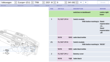

Well, a guess - based on data from IFInterface
Certainly needs double-checking against exact vehicle type etc.
PS. Welcome to Forum :thumbsup:
EDIT (29MAY2021) - updated screen captures - with pictures.
Extracted from
Hi MMi
thanks for the reply
so if i am reading that correct
top Position 1 (right 4 buttons top right) is the windscreen heater which i have
top Position 2 (right 4 buttons top left) is a blank and doesn't have a button assigned
Bottom Position 1 (right 4 buttons bottom right) is either "stand regeneration" or "mode"
Bottom Position 2 (right 4 buttons bottom left) is a blank and doesn't have a button assigned
If the above is correct couple of questions:
1) can i add the "Mode" button? will it have any functionality?
2) is there any buttons available for position 2 top & bottom from over seas models or different trim models? really don't want to drill and insert a push button into the blanks if I can help it.
3) what is the "WLan, Bluetooth" button for?
Thanks again for any help received
The way I understand is that the 4-button block consists of two switch modules - upper and lower. Thus solo switches are not available.
So possibly you could replace your "Windscreen heater (only)" module with "Wlan/Bluetooth + Windscreen heater" -module.
It seems that for lower module available are only either "Regen" or "MODE" modules.
I'm not sure what's the Wlan/BT was meant to do. Possibly related to a special versions of T6.1 - VIP Bus or taxi??
No good ideas what the MODE was meant to do.
I guess you could you use any of these "new" ones as general purpose switches. Most likely there is no wiring present on van's side.
Anyways, I haven't had any of these in my hands - so no responsibility accepted ;)

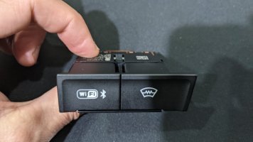

Did you pop them out? Can you give me dimensions (I don’t have my van)? I’m looking for somewhere to fit an amplifier remote control knob and thinking this maybe here.
yes but MMI was correct they are combined units the top two buttons and then the bottom two no easy way to retrofit any sort of button in the blanks provided without cutting away the casing of the entire button. i have one with some little hidden buttons on the side of the passengers seat box and they work great and not noticeable until your looking for them

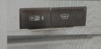

I've ordered the [wifi / windscreen heater] centre right upper cluster (pictured) from a Multivan and will connect it up to the aftermarket spot lights + camping lights on my California, where I've currently have a blank.

I ordered the Inner Right Top button cluster from VW Germany (similar position as you indicated- but for T6.1) from a MULTIVAN which are [BT/WIFI - DEMISTER] switches.
I don't have the part number on me right now.
I'll cover up the original icons with digital label printer.
The catch is that these switches are "occasional" ie. don't stay on and therefore require a Flipflop or "chopper" relay to activate the lights and keep them on.
My auto electrician is making me a pair (2x switches = 2 flipflop replays - front driving lights + roof camping lights) but you can buy then also from REDARC, who i'm sure you've heard of. However they aren't cheap @ $180 each. Latching 'Chopper' Relay (Flip-Flop)

The installed result.

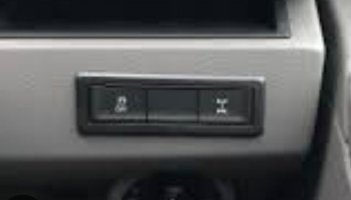

Can anybody advise on the availability of the blanks show in the attached image?
T6.1 to which I need to fit a small rocker on off switch, looking at the component, I can make it fit if necessary but would like to experiment before the modification
Some quick googling results
7LA927202D WZU (switch module)
7L1857857 9B9 (frame holder)
6R0972930 (plug)
Not sure about switch module, probably @X88POW can confirm the correct partnumber or @mmi
Need a switch module with all 3 buttons (ESP, HDC and Diff lock)
