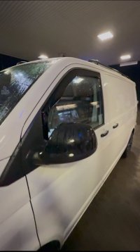

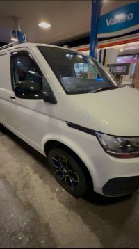

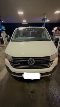

Sure apologies about that! I took ownership of my T6.1 2021 highline a couple of weeks ago. It’s booked in for the conversion in 6 weeks time with a company close to me in Chesterfield.
I bought the van from auction and it’s in great condition, I’ve started to do some minor styling myself before the conversion starts. See photos of my van attached.
