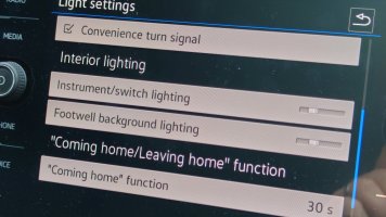

On our T6.1 Caravelle there are two level settings on the lights menu, instrument and footwell:
I don't have that menu but it started out as a basic panel van so that maybe why. I wonder if that menu is something that I can code in with VCDS.
Might be on the simpler spec they just run off the same dimmer setting or maybe not at all.
