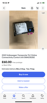

I believe the Control Unit 1 - J794 - is VW Part Number 5WA035282 - But i cannot find it anywhere
If i go on All-data it shows it to be located in the dash area on the passengers side - however, I've had most of the dash out and i cannot find it
Can anyone Help???
