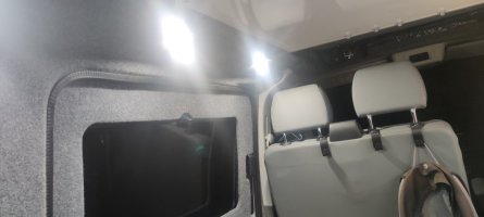

Thanks all, any input regarding the lighting changes also greatly appreciated, I have 4 recessed spots that you push the centres for them to switch on and a reading lamp above the bed - I always bang my head on this!!

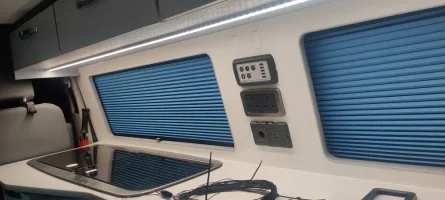

There is a controller by the worktop that turns on water pump - this also don't work, a small LED light strip - this works, and a switch to go between leisure battery and a button that says 'v' which I assume is for vehicle battery?
I would sooner not involve this for the spots as these would be handy to be able to have on independently from the LED strip, so straight to the leisure battery via the fuse panel I assume.
Wow I amaze myself, the lights do all work from 12v!!
But, to have any of them working I have to turn on the Sargent EC50 control panel. Is there a way to have the lights on without needing to turn this panel on? So the spots above the door can be turned on and off without the need for the big LED strip light being on?
