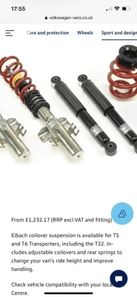

Can someone who knows about coil overs let me know if this can go any lower? Looks to me like it could, but dealer wasn’t sure. Thanks

I am picking mine up next day or two , the back is being lowered as far as possible and then the front to match , apparently the back doesn’t go as low as the front to allow for load in the vans , not sure about the kombi , just trying to set mine up so it looks even as I don’t really carry a huge amount , I will send pictures once I have it

He’s matched front to rear .. he won’t get rear down anymore without a adjuster delete
I have ordered a adjuster delete from thq I had the problem still 20- 25mm left on front even took all the adjuster rings off @ rear but still not enough for me ..

I took a Sportline black edition out this morning which had these Eibachs fitted wound right down on the front, it drove better than I was expecting with 18’s on it. Non black editions are fitted with 30mm springs only.
Have ordered a new van and torn between above or 30mm springs, but? Will it still drop at the back with work gear in.
Yes, it’ll still drop at the back with work gear in, depending on the weight of the gear. If it’s one battery drill then no, but if it’s a load of tools and materials then yes, it’ll drop.
