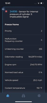

Hi, Thanks for getting back to me on this. I have Carista which gives the following information in addition to the fault codes:
View attachment 264331View attachment 264332
I'm afraid the information provided by Carista doesn't help much as the sensor readings were not captured.
Anyways, replacement of the sensors likely cures the issues, unless it's a wiring fault... that's why would have been useful to verify the values ECU is seeing.
