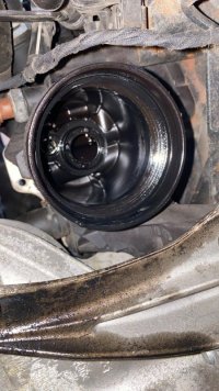

I decided to change an oil today. Last time I had it done at the garage and decided to do it myself today. So there’s my problem:

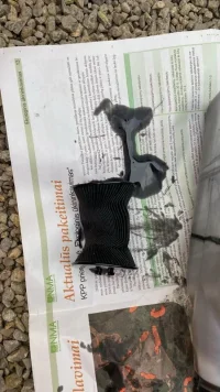

I’ve taken oil filter and it was twisted. I watched videos on YouTube and spotted that inside the housing there’s is spring or something and in mine there isn’t. So should there be something?

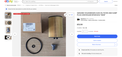

whats the new replacement look like?

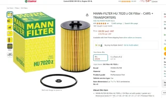

a quick look shows these examples.
one new filter, with two new o rings.
If it is that squashed it looks like they have installed the wrong filter (or installed it incorrectly). Typically garages get the apprentices to do things like oil changes, so not surprising if it has not been done correctly.
