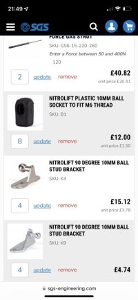

The design isn’t complete yet, so the brackets might change, but this is a draft list from SGS. 120N chosen because I saw a photo of 100N Reimo ones on here, and more is obviously better. Struts will be 6mm stainless rod off Amazon, which I’ll tap at each end for the connections. Piano hinge from local hardware shop.
