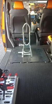

Next issue is keeping them tied down, you need a VERY good tie down system, imagine your bike coming through the front screen in an accident when the tie down points fail.
I use an Acebikes Steady Stand bolted to a 4mm thick steel plate that uses the points in the floor for the rear seats in a Kombi to keep it in place, then some Moto Clix strapless tie downs to keep the bike solidly upright so it doesn't lean over going round corners and risk damaging windows.
I don't have a picture of the complete set up but here's a few to give you an idea.

The first issue with putting bikes in the back of a van is getting them in and out.
I can 'just' get my KTM 690 in my T6, but there's no way my GSA would go in without some disassembly, the screen is too high and I'm not sure I'd be able to hold the bike up if anything were to go wrong during loading and unloading, that thing is HEAVY.
I use 2 aluminium ramps (one for the bike, one for me) to get it in and out. These then stow alongside the bike wheels strapped together to stop them rattling.

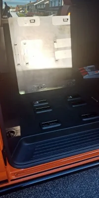

That plate looks interesting. I have a Kombi and just starting to get everything together. Does the plate latch in like the seats do? Strikes me as a great way to carry my bike, and on trips with no bike.. add 'habitation' modules for camping?
Cant see how it latches in or out, if it does?
The bits of (rectangular) steel tube welded to the plate have a cut out in them, these latch onto the bars in the floor mounts, I have another piece of tube with a rivnut fitted to it that drops into one of the middle floor mounts in front of the bar, when the plate is in the right place (fully engaged in all corners) a hole lines up with the rivnut, a bolt is inserted, and the plate is effectively locked in place.
It is quite difficult to get the plate in and out anyway, but this bolt makes it impossible for it to move backwards in use.IMG20190525161725.jpg
It is quite difficult to get the plate in and out anyway, but this bolt makes it impossible for it to move backwards in use.View attachment 87417
