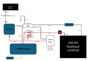

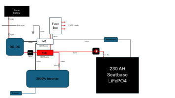

Hi all,
Can some kind soul please cast an eye over my proposed electrics please. No solar
Using the following:
230Ah Seatbase Battery (still to buy)
Victron Orion TR 30A DC-DC charger
Victron Smart Shunt
Renogy 2000W Inverter
Couple of things to clear up please
Victron Smart Shunt
- What is recommended between DC-DC charger and positive busbar in terms of isolation/fuse?
- What size fuse do I need between 230Ah leisure battery output and positive busbar?
- What benefit will I see from swapping out the DC-DC for the new 50A - I've never noticed the 30A getting excessively hot in old van
- Have I got the Smart Shunt in the right location?
