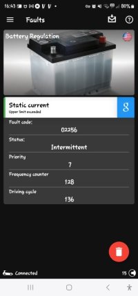

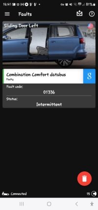

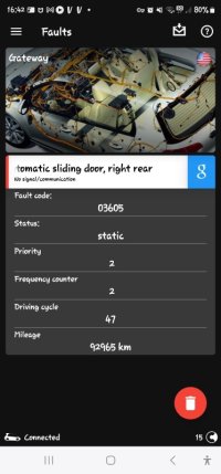

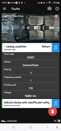

Can anyone help? I have a 2017 RHD T6 SWB kombi with electric twin sliders. The van is converted to a camper.
When I unlock the van with the key fob and then use the key fob to open the passenger side sliding door the drivers side slider cracks open (just opens).
The drivers side sliding door now won’t open fully when I manually pull the door handle nor will it open if I use the fob or from within the cab using the door open buttons.
Iva even having problems with the starter battery and am in the process of having a new one fitted post Christmas.
Any help or advice would be welcome.
