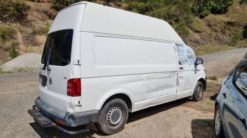

Hey brains trust.
Got this van at manheim auctions.
2017 Transporter T6
ex Linfox Tobacco Transport van, WOVR.
Arrived stuck in park, drivers window half down. They dragged it off the trailer as is, and didnt find the yellow leaver park lock release under the gear boot flap.
Van wont start.
- central display lights up upon door open or close.
- cluster lights up when parkers/lights turned on
- bluetooth radio comes on with key in acc, syncs to phone, works fine
- interior lights work fine
- no dash warning lights light up
- cycling the key doesn't affect the dash light activity
- parkers work, but headlights dont come on.
- Hazrad lights flash and work
All the fuses and relays seems fine.
The battery is low and maybe had it, but have tried other batteries and big truck jump packs.
I tried a mid range obd2 scan tool, and cleared all the codes as it had a few eletrical faults for low and high voltage
Only error code that reappeared once is "Return message regarding driver door closing condition-implausable signal"
- yet the drivers door functionally works fine, handle and locks ect.
- the dash center display correctly shows the door open and close on the graphic display
- the windows, both, wont go up or down, but the window switch is broken/faulty, that was also one of the old fault codes that got cleared.
Have taken the dash under trays off and cannot locate any tampering, any removal of immobilising trackers or anything.
The factory immobilising light at the lock pin in door seems to function as it should when locked it flashes, when unlocked it doesnt.
Im out of ideas, and cant get it to even crank or light up the dash warning lights....

Removed the final dash panels behind the light switch and noticed the ends of 3 snipped wires in the loom, also
Found on the braid of wires coming from the ignition that a single big black line with blue stripe was cut, diverted, and never reconected after the aftermarket whatever had been removed. They also went to the trouble of taping it mostly up again all neat so that whatever was done was barely visible. either that or they snipped it so close to the electrical tape that it seemed neat and tidy and untouched.
Soldered the big black and blue line back together, and we had a running car for the first time! the other 3, inside the zip up sausage of wires, they were mainly spliced added wires, and only 1 of three needed to be rejoined. the other 2 trimmed and removed.
Car runs and moves around the carpark, found out i got 80% of a tank of fuel for free also!
