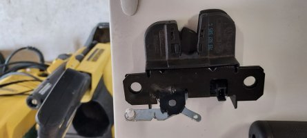

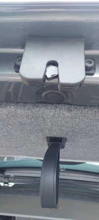

No it was the locking mechanism at the bottom of the tailgate. The bit that latches inagainst the striker plate. I will send 2 photos.
1st pic is the new assembly fitted. 2nd are of the old assembly, plus label with part number for my assembly.20220819_124207.jpg20220819_124340.jpg20220819_124329.jpg
