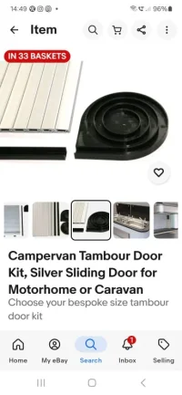

Hi very knowledgeable people. I had a Tambour roller door that was sticking a bit. I forced it and the whole roller part came off the round black guides.
I cannot work out how to get the roller door back on. Probably being a bit thick but can't work it out.
It has to slide through the 2 straight guides each side of the door and then through the circular guides at the top as pictured.
Anybody here that can help ?
Thanks
@FunkyClaude I removed my tambour door due to it sticking and to get the old one out i had to remove the 2 guide rails pull the door out to refit was push the door into the spiral bit then refit the guides mine had 2 tiny screws in the guide to secure them very easy to do maybe your door is not quite wide enough for the opening if it pulled out guides plus i sprayed the spiral bits with a bit of silicone spray work a treat now

At first I thought I would have to remove panels until I realized the black guide track was screwed on , the door I found easier to roll up first to get it in the cupboard then let it unroll then feed it into the sprial
