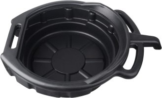

Unscrew the sump plug and pop a pan underneath. Just watch where you place the pan though. The oil comes out at an angle.
Screw a new sump plug back in.
Move the pan and undo the small nut (bung) 1st using a socket (13mm I think) as seen below and let the oil drain out the filter housing.
