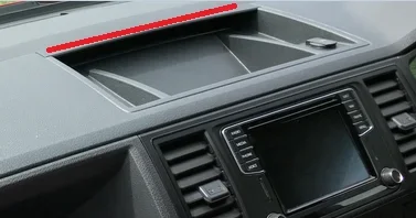

I know that this is an old thread but can anyone tell me if the front lip of the standard top dash tray comes off. I've looked at ETKA and it looks to be a separate item but it's not obvious how it fits and I would prefer not to break it using a trial & error method.
I want to run a small cable through to inside the dash for the power supply to a dash cam and that looks the most unobtrusive way to do it.

This?
It comes off - pretty much just straight up. Same type of clips (yellowish ones) as in top of radio surround panel (the air vents).
I know this is a bit old. Does one just pull straight up or do you need trim removal tools to get underneath the bottom?
Straight up - a better picture here --->
Thank you.
