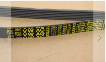

eg
Description
Repair kit for drive belt for alternator, power steering, air conditioning.
Kit includes:
1 x ribbed drive belt
1 x automatic tensioner unit (latest revision)
Fitment
VW Transporter T5.1 all 2.0 TDi models with Aircon
VW Transporter T6 all 2.0 TDi (not for vans with adblu) models with Aircon
Brand
Genuine VW
Condition
New
![1719388733112.png 1719388733112.png](https://www.t6forum.com/data/attachments/247/247263-fa533c48ebb1a4ba1eec3f13fb7a653f.jpg)
![1719388740929.png 1719388740929.png](https://www.t6forum.com/data/attachments/247/247264-a9a0078a6cfb5523420dc575a67c8ab2.jpg)
VW Transporter T5.1 / T6 alternator belt & tensioner kit for 2.0 TDI all models except those with Adblu
