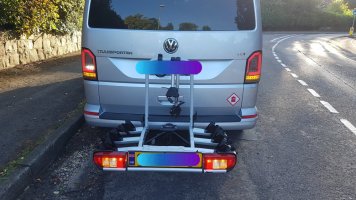

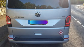

Hi, I recently had a tow trust bar fitted to my T6 Tailgate (2016) with the VW specific electrics kit. The parking pilot knows when the tow bar is attached and turns sensors off etc however one of my reversing and fog lights are no longer working.
I've seen that some T6's only have one functional fog and reversing light, however I'm assuming retro fitted lights have one on both side? (These were already fitted when I bought the van last year). If so, is there a fix to get both sets working again?

I did mention it to the fitter but he seemed to think that either there was only one reverse light or the bulb might have gone. However, it was only when I looked at it again last night I noticed the fog light was only on one side too

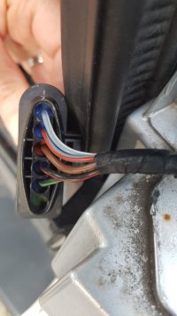

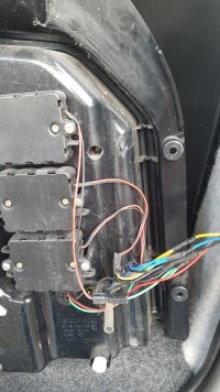

pop one of the lights off and how many wires you have connected to the light fitting
Its a 6 pin plug and will need all six in use for double fog/reverse lights, if you only have 5 wires into the six pin plug then they have never worked

So from the first pic they have never worked on both sides??
